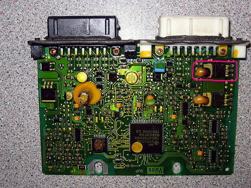

I'm not so confident its as simple as that Peter because if the diodes fail there's a very good chance that one of the VN05N's within the ECU will have been fried as happened to my HDi, after all the main purpose of fitting additional diode's is to prevent failure.Peter.N. wrote:The most common problem with the ECU is failure of the diodes across the electrovalves, if you are handy with a soldering iron you can fit a couple on the PCB.
Here's a photo of the failed component,
As it happens I managed to source a replacement VN05N and soldered it in, however again its not so simple because after any such failure the ECU will register all manner of codes and end up locked into firm mode anyway, so unless you also clear the faults with a Lexia/ELIT/Proxia you'll be waisting your time thinking that soldering in diodes will sort it out.
