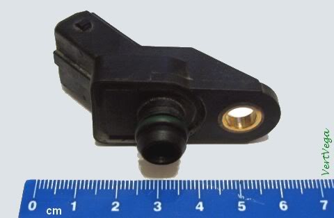

Edit: this's the broken sensor from mine
