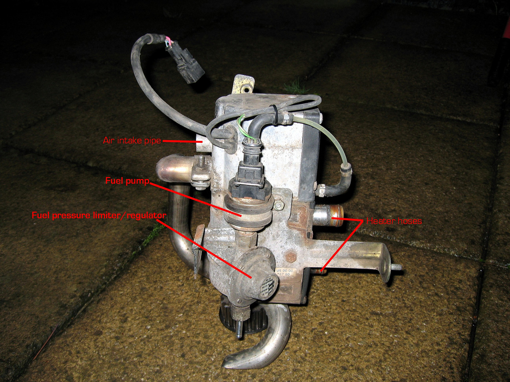

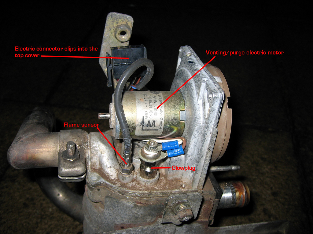

I've found a good link that explains how the heater works here
BTW the heater is not a Webasto, its a Eberspacher D3W which is a variation on the ones fitted to VW T4 vans and Sharans/Galaxy's.
Here's some photo's of the one fitted to mine
