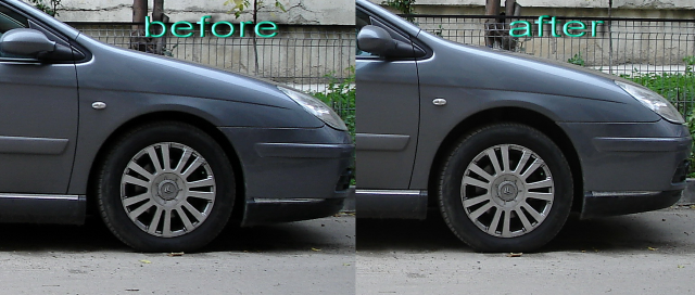

this picture is taken after 12hours since the car has been parked. when i stop my car both sides (Front &rear) are at the same height and stays in this position for almost 4-5 hours when the front corrector keep correcting till the computer will shut down power (economy mode).
I can assume that is a very small leak of pressure (air or lds - not enough to leave spots on road.
how can i check for leaks?

If the car is locked then the suspension pump should not be running at all. You usually hear a whirr from it as you unlock the car as it adjusts the height.viorelovidiu wrote:this picture is taken after 12hours since the car has been parked. when i stop my car both sides (Front &rear) are at the same height and stays in this position for almost 4-5 hours when the front corrector keep correcting till the computer will shut down power (economy mode).
Have you tried leaving it in the highest or lowest position?

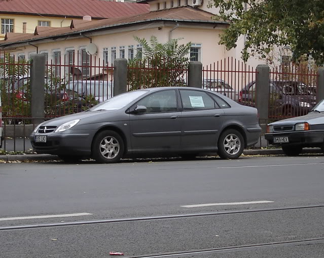

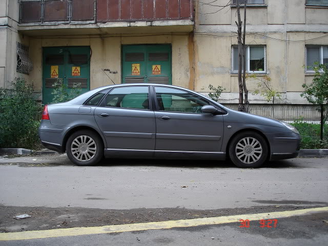

good evening!
someday i went to a small citroen service with engine turned off but the car wasnt locked out. During almost one hour of chattin around car about suspension problems we sensed 2 or 3 times how hidraulic pump was working for 1sec and the front side rises slightly at that time like it was loosin pressure.
i attached a picture how i found my car and after unlockin it.
and a car seen in town
as you can notice both front and rear side are at the same height
if i let my car into higher position overnight i can notice the same event: front side is lower than rear side...

cachaciero - thank you so much for this very well & good information which will represent a good start for checkin suspension when i`ll reach a citroen service next week.
I agree with all you say and I have to find which one is correct: "The suspension is dropping either because there is a leak in the system OR because the system is driving it low" - lexia could told me if doing so or not?
But in my mind I still have a big question to you and all citrofans
Why removing right cylinder and how it can be cleaned and after remounting it, my car gets down after a couple of days and not in 2 minutes like before?
actually were 2 questions...

I am going to observe mine more closely for a while and see if there are any similarities but I can say that I have never noticed the front or rear dropping significantly.
The struts are designed to leak slightly, otherwise there would be no need for a drain/return circuit.
I had a leak on mine about a year ago that was from the rear right return, it was just a slight nick in the bellows, the leak was very slight though, just wet the bellows and allowed a couple of drops overnight, less than a millilitre.
The pump on mine is completely inactive after locking the car - they will dance around if the car isn't locked, especially if parked on an incline or for some reason if the steering is turned a long way from centred.
I leave my car unlocked and the keys in all day at work, it never goes into economy mode unless I leave the CD player running.
After being left for a couple of days, it is no different than overnight. On unlocking the suspension motor runs for around 3~5 seconds, then again when I sit in the car, before it is started.
If I leave the CD player off. I can hear it run every 2~3 minutes.
How long has your car been behaving the way it is viorelovidiu?
