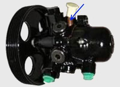

Hi, I've recently noticed some surface cracks on the hydraulic hose that goes from LHM reservoir to the HP pump.
They are only on the lower part, near accumulator. There's no leak and no sweat (yet)! I guess that'll not last for a long time.
I've measured connector pipe diam on the reservoir side but it's not possible on the pump side.
Also it seems that outer diameters of the hose are different at pump and reservoir side. Is that possible? Has anyone replaced this hose?
- Do you know the outer diameter of the connector which is marked in the pic below? (pic from eBay)
- Is it possible to use a fuel line hose for replacement (is it LHM resistant)?
Thanks in advance.

That hose will be the low pressure feed to the pump. The cracking is deterioration to the rubber caused by various factors like , heat , ozone , oil etc. All rubber deteriorates over time , the compound it's manufactured from determines how long it will resist the various environmental factors.
There are three main parts of rubber hose construction , the tube (inner part) , reinforcement and cover (the outer part). The inner resists the medium passing through the hose , the reinforcement resists the pressure or vacuum and the cover resists external conditions. In this case the cracking in the outer cover allows external conditions to affect the internal structure and the rate of deterioration increases. At some point it will fail , but when is impossible to predict. It can be seen as an early warning.
Regarding different sizes at each end , this often occurs with bespoke hose units made for OEM on cars. Each hose is made to a drawing specifically for each application , there is very little general purpose , by the meter hose used on modern vehicles. Many hoses are moulded to a specific shape with ends as required.
LHM is nothing more than a mineral based oil with specific properties for Citroen's application , any nitrile lined hose will resist it's effects. Any quality fuel hose will resist LHM.

The important end is going to be the reservoir end , that can't be changed. So whatever size that is determines the size of hose. The pump end can probably be changed by using an adaptor to match the reservoir end so the same size hose will match both ends.
If you can find out the reservoir end size I probably have some suitable hose.

Thanks for the tip DickieG, That's the most suitable and the best solution for this case.
HDI, I measured the reservoir end which was 13 mm. So inner diameter of a new (fuel line) hose should be 12 or 13.
But I'll check breakers.
