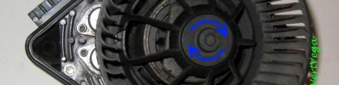

On LHD Xantia heater blower spins clockwise (An air puller).
If this info helps a bit :)
Edit: Here's a pic. where blade curves are seen.

No the impeller even points in a different direction

If I'm not wrong ONLY full speed means that control module transistors (see above pic) are gone and full current passes through.
2 transistors can be replaced.
