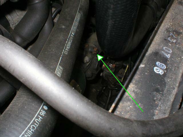

Jim where is this
"depressurise by opening the 12mm bleed valve on the pressure regulator by no more than half a turn and go back,"

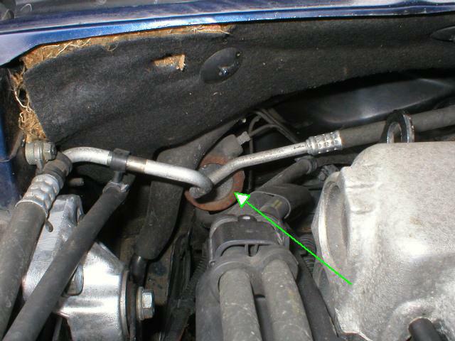

Look at the front of the engine Mark, near the gearbox and you'll see the accumulator sphere . Look aat the block it's screwed into and there you will see it. The bleed screw is the only 12mm size on the whole car virtually.
This picture shows it on an Activa but a 1.9TD is almost identical here.
Only undo the screw about half a turn and no more.
Strictly, it's not really necessary to depressurise to change spheres. As long as the suspension is on low, there'll be little residual pressure left and on the V6 I never do because this screw is so hard to reach!
Open it, on a hydractive, on low and with the engine still running.
