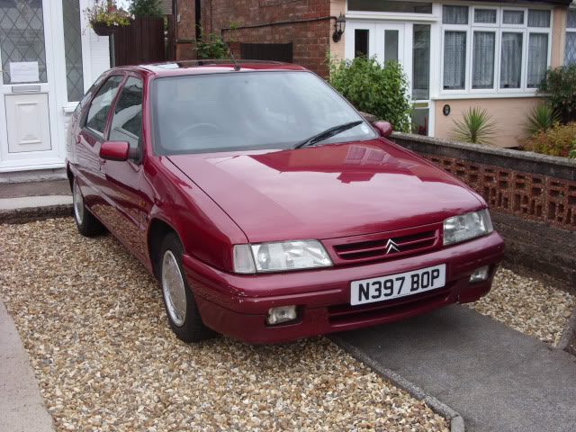

I have just bought a Citroen ZX 1.9 Diesel car.
I have a couple of questions really!
First, the brakes don't seem quite as good as I think they should be and was wondering if there might be something wrong with them although it did pass an MOT in July! They just don't seem to bring me to a stop all that quickly (my other car has discs all round and that stops o a sixpence!)
Secondly, the car seems to pull slightly to the left constantly which I thought would be tracking but I rang a Kwik-fit up and he said that it may not be tracking! the drivers side front tyre does have some wear on the inside edge of it but the nearside tyre is ok! I am a bit confused about this.
I have put the right tyre pressures in as I thought that could be the problem but it wasn't.
Any help with my little problems would be very much appreciated and I thank you all in advance of this.
I must say that this little ZX is a great car and I have managed to get 60mpg out of it (which is why I bought it as I am commuting to work over 100 miles a day!)
Kind regards
Paul[/img]
