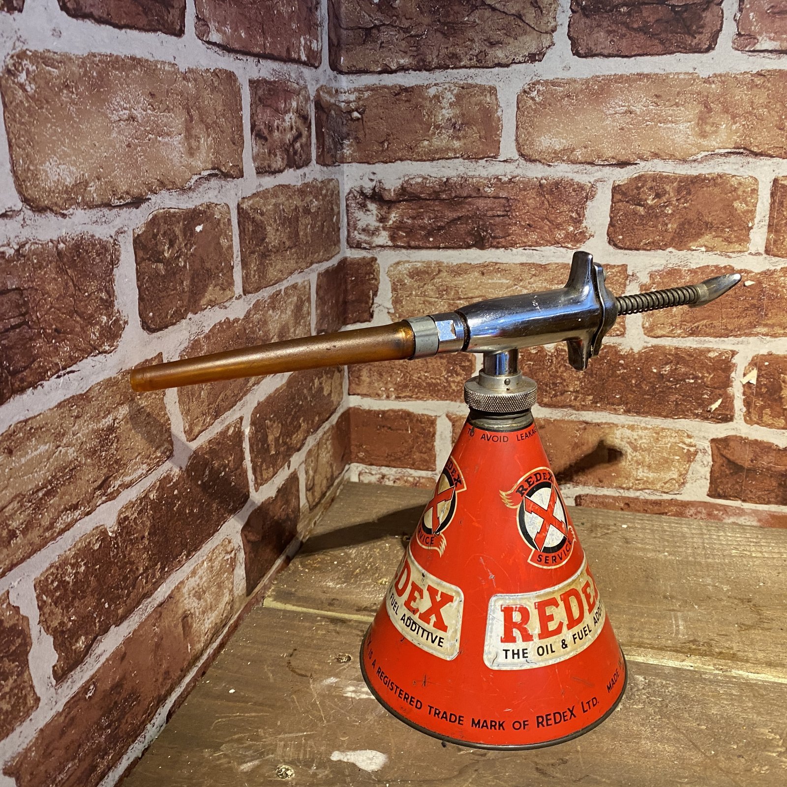

Soon, at a petrol pump near you....
Stuff always come back even if for a differing reason :)
