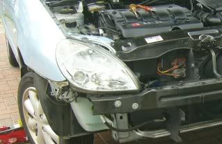

You won't get the headlights off without removing the bumper. Also the cross member will have to be removed because one of the bolts is behind it. See my piccy:-
Headlamp bulbs can be replaced with lamps in situ. It's the sidelight bulbs that can't be reached. It's worth doing both sides.
