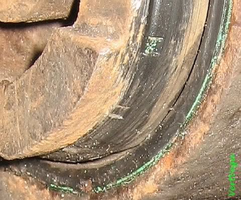

In this "Xantia Front Brakes Overhaul" thread ( http://www.frenchcarforum.co.uk/forum/v ... hp?t=27997 ) I have included some pictures
but unfortunately I have never removed piston during overhaul. Since you have removed it, can you send some pictures. It would be nice to see components, seals etc.
Below is a partial close up (before and after picture) from lower part of the piston where seal and gap is seen clearly. You won't disturb any seal there, I guess.
As Peter.N. said apply LHM to all sliding parts and seals. It is a good medicine
Turn piston (clockwise) and at the same time keep pressing. When piston is completely in then below gap will disappear and only seal will be in that area.

Vertvega; read and saw your previous postings - your piccy shows the dust seal that I'm struggling with.

To slide the piston back into caliper, I need to spread the lip of the dust seal. I'm thinking of using bit of a plastic bottle to use as a sleeve, if can find one of right diameter - unless anyone's got a better idea
