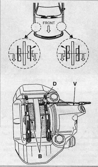

If my memory serves me correctly the car will have solid discs, and the pads will be held in place with metal "L" strips. (Bendix system)
I seem to remember this set up being very problematic & the outer pad often jambed & somehow stopped the caliper sliding, this was evident as the inner pad (next to the piston) was quite often worn right down while the the outer was still next to new.
I seem to recall filing a little off of the metal horn of the pads so at to make them not such a tight fit helped cure this problem.
Just had a look at the Haynes Manual & it says that the pads have to be fitted a certain way so check that they are correct...
From the Haynes manual....
"looking at the pads from the front of the vehicle, the innermost pad groove must be higher than the outer pad groove"
HTH.
