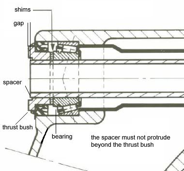

I also read on here that I may have to shim the bearings in place. Is this right? And if so can someone post a link to the thread on how this is done?
Maybe I'm jumping the gun a bit, normally things aren't too bad once I get into the bones of a job. Just a bit concerned.

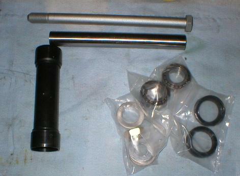

This is the contents of the kit Martin..
Bearings, seals, spacers, ground axle, through bolt and nut. In short, everything you could possibly need bar the arm itself!
David is quite right, providing yours has not gone too far, the bearings and seals should be all you will need.

Don't worry about the shims --- simply reuse the old one if indeed there is one fitted. The shims are simply used to compensate for manufacturing tolerances. The kit does not include shims.
If you study the Citroen service documentation you will see that there is a special Citroen tool which is supposed to be used to determine the correct size of shim to be fitted. The aim of the procedure is to ensure that the spacer or axle, on which the bearings and thrust bushes are mounted, does not protrude beyond the thrust bushes as indicated on the diagram below.
