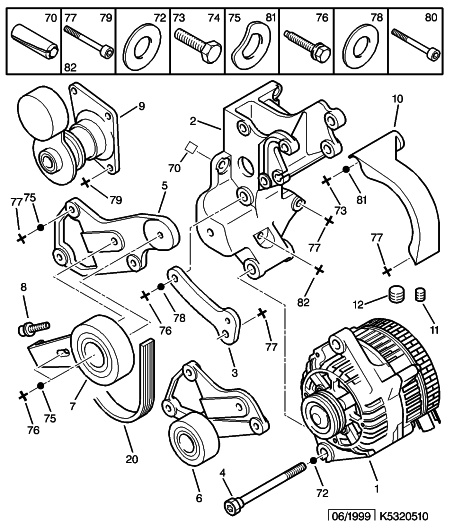

Larry,
Going on the pictures, you have the standard early A/C manual tensioner set-up, the one that Haynes describe for the 1.9TD in the Xantia BoL. What they call the 2.1TD setup in the picture next to it is in fact the later automatic tensioner with the eccentric pulley and big spring tensioner also fitted to later 1.9TDs.
To show the essential difference, have a look at these diagrams.
This is yours:
Whereas this is the later automatic tensioner:
This is yours:

Yes that's right I have the top diagram. Therefore guess I'm manual
Funny thing, is I went into Citroen this morning and they said i should definitely have the 6PK1736 belt, and saying my pulleys must be worn... yet the picture they showed me was the 2nd one you have posted!
There was another size 6PK1726 recommended for Sarten aircon instead of Harrison, but I have Harrison... so it's all quite confusing
Anyway to make a decision, I went to a spare parts place and have got a 6PK1725 ... hoping that this will make the difference.
Cheers
Larry
