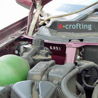

Thats what an RP number looks like and where you would find it on a Xantia.
Thats the RP on an XM
You might be lucky it could be in one of those places on the Synergie. Sorry even a mighty Google search has drawn a blank.
Once you have this number you need the ignition on to the second position (just before started motor engage) for the lexia to communicate with the ECU's
