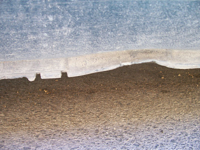

However I have been a bit of a Jack Ass and need some advice for future work under my car.
I explain:

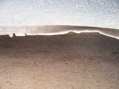

To make sure that the Axle stands would be at the support/jacking point under the car, I put the jack in the adjacent position, hoping it would hold, so that I could slip the Axle stands in the correct positions. However as you can see by the pictures, I've made a hash of the underside of my car.. doh!:
Questions:
1. How do I jack up the car in a safe place, allowing me to slip on the Axle stands in the right place?
2. I have a trolley jack, but dont know a safe place for rear and front to put it, and am afraid of doing damage in a more serious place on the underneath of the vehicle... where are the best places?
Yours
Jack Daniels
(1996 Citroen Xantia 1.9TD LX with aircon)
Living in exile in Spain

Don't beat yourself up about this - garages do this all the time - I myself have bollocked tyre/exhaust fitters for this "but there's no where else to jack it up" well thats funny because I can do it without causing damage.

lazza wrote:How do I do it without damage?
Place a decent strength wooden block on the jack, at the front place the jack below the subframe under the two subframe mounting bolts (set each side), at the rear place it to bridge across the gap in the rear strut locating frame (just forward of the sphere).

i usualy just place a trolley jack under the two bolts which hold the small diamiter bar which goes across from one side of the sub frame to the other,
this point is very substantial,
never jack on the door sill edge apart from with the propper jack supplied with the car, and only use it on the corect points

Don't jack the bar, jack where the bar is bolted to the car.
For the front, look under the car just behind the front wheels, you'll see a large nut, that's where I jack from, which keeps it steady.
Set the car on high, put your jack in place, raise it up with the jack until you can fit the axle stands under the sil's jacking points, set the car on low, and it will raise the axle stand up in the air giving you plenty of space to work underneath safely, without having to actually lift the car that much.

I always use the reinforced metal plate on the rear off the front subframe to jack the car up with a trolley jack from the front of the Xantia (making sure the rear wheels are jocked first), then I put my axle stands between the rear front subframe mounting bolts.
Balance whilst jacking the car up usually isnt a problem because the reinforced jacking plate is already centred for you somit is easy to place the trolley jack in the centre of the rear section of the subframe. tryn not to get under the car whilst jacking it up, only proceed underneath once on axle stands.
you should be able to straighten that mess out with some mole grips and a bit of brute force, which might loosen the protetive layer a bit just brush in some underseal where the surface breaks loose and you'll be back to square one.
