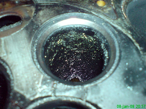

Are the heavy deposits a bit like this?
These are from a 2.5 TD. EGR related I'm sure. The engine didn't half run clean afterwards.
Steve.

Nice one!
Yes they are like that. Makes you wonder doesn't it.....is it all about engine emissions being cleaned up no matter what happens to the valve seats and all?!
Disconnection of the EGR is starting to look appealing.!
Cheers for photos :)

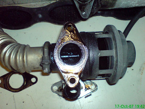

Here's how the EGR looked from the same engine -
And here's how I blocked it off with a metal disc -
Steve.
