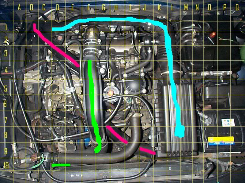

Pipework air flow.....
(I'm only going from the photo as I don't have a Xantia)
It looks to me that.....
The Blue line is the airflow to the Turbo.
The Pink line is the airflow from the Turbo to the intercooler.
The Green line is the airflow from the intercooler to the inlet manifold.

You won't...you will get a blast of air from the end of it if it is still connected to the intercooler tho...assuming the intercooler isn't blocked.That fits in with my understanding but what i an't work out is why i'd expect to get a blast of air from an inlet manifold pipe when i disconnect it from the intercooler, surely there should be suction at this point ie pulling cooled air through the intercooler and presenting it to the manifold or am i way off beam in my thinking?
The air is sucked through the air filter & through the light blue pipe into the Turbo
The air is blown from the turbo down the pink pipe through the intercooler up the green pipe to the inlet manifold.
Cheers.

Disconnect the pink pipe where it meets the intercooler & rev the engine, there should be a lot of air flow as this pipe is coming directly from the Turbo so the air will be being blow through it....put this pipe back on then.....
Disconnect the green pipe where it joins to the inlet manifold & rev the engine there should be a lot of air flow as this pipe is coming from the intercooler.
The air flow should be exactly the same from both of these pipes...if it is not & less is coming from the end of the green pipe where it joins to the inlet manifold there is some sort of blockage in the intercooler.
You said in a earlier post that you had the air filter housing off the car, you didn't stuff a rag or something in the end of the pipe from the air filter & leave it in when you put it back on or anything silly like this?
I think you need to stop & start again from the beginning with this problem as I think things could be being assumed....you should never overlook the simple things when fault finding.
