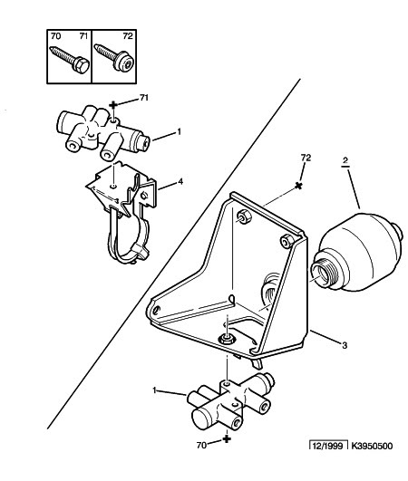

I'm just dismantleing a Series 2 1998 Xantia SX, which appers to be completely leak free.. Ill certainly make an effort now to keep the said valve..
Anyone have a picture so I know what I need to recover??

Paul the front one is on a bracket just below the edge of the hydraulic tank,
item No. 1 in this link
http://service.citroen.com/docpr/affich ... 3%20395050
regards malcolm

JamesQB
Posts: 377
Joined: 13 Aug 2003, 18:01
x 5
Unread post by JamesQB »
There you go...
