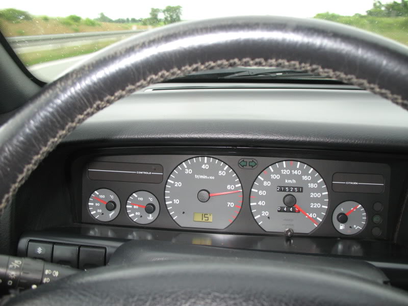

Had at some point a similar experience, when semi hot, on a hot day, it started instant, like always, but was somewhat destabile, just for a seccond, and stalled, then it was much more diffficult to start it up again. It wasn't me who was driving, i only stood a looked concerned, then took charge, a had a 3-5 sec. start up sequence.
Is it me or do those ES9J4 really radiate heat and build up, even with 82 C. on the water, and a 90 C. on Oil, the engine bay is really hot, and even after 3 hours it still contain some heat. New radiator, new matrix, wented, no leakage and level okay.
Can we have a reality check please
Engine oil :
Motorway at normal speed 60 mph : 90 Celsius
Excessive motorway speed 100 mph : first mark after 90 Celsius( 110 C )
All-in @ motorway speed : seccond mark after 90 Celsius( 130 C )
After that run it was hot, for a week...just kidding :wink:
Sorry for somewhat high-jack, Jim :oops:

That's quite a picture you have posted above Christian :D :D So they are fast then :lol:

At 80MPH, my V6 oil temperature sits at about 90 degrees, +/- depending on ambient temperature. I have seen 110 on a hot day at 90MPH. At 60 MPH, it would be a below 90 degrees.
I don't think that these temperatures are anything to worry about.

110 @ 90 mph..okay, but above 120 C. is pushing the envelope for sure.
Running on 15W-50 or 10W-60 when i can get a fair deal.
But nice to know it's somewhat normal Citröen and finding yet annother reasson for 90 Mph-ish travel speed.( ticket and/or ban, Mpg )
