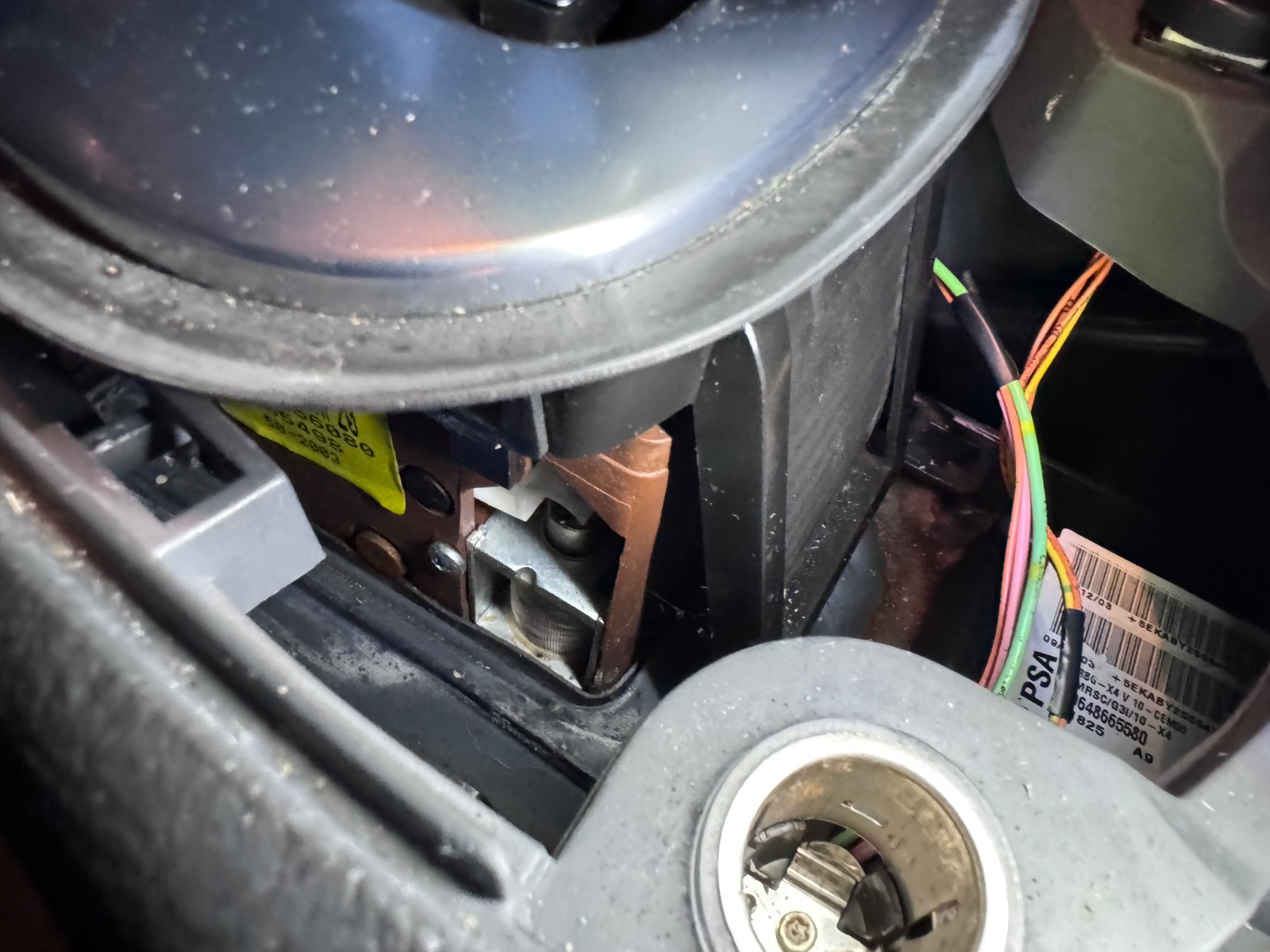

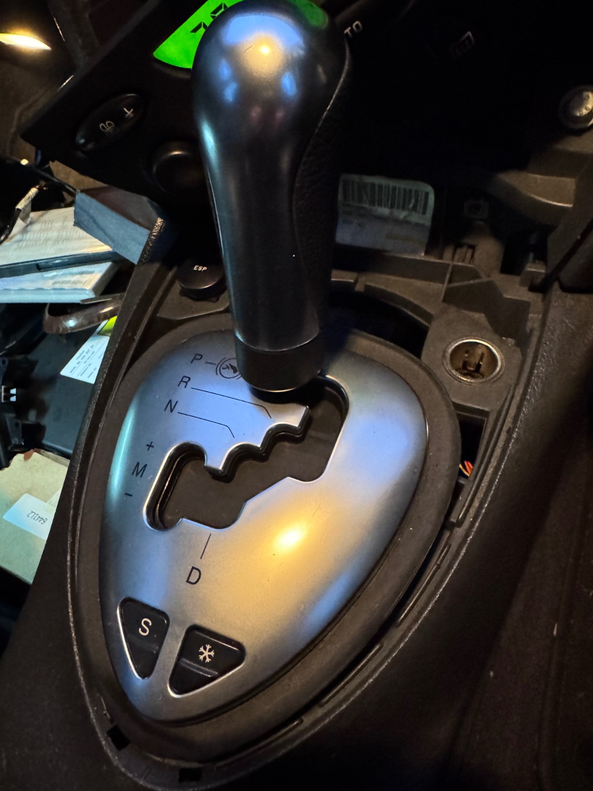

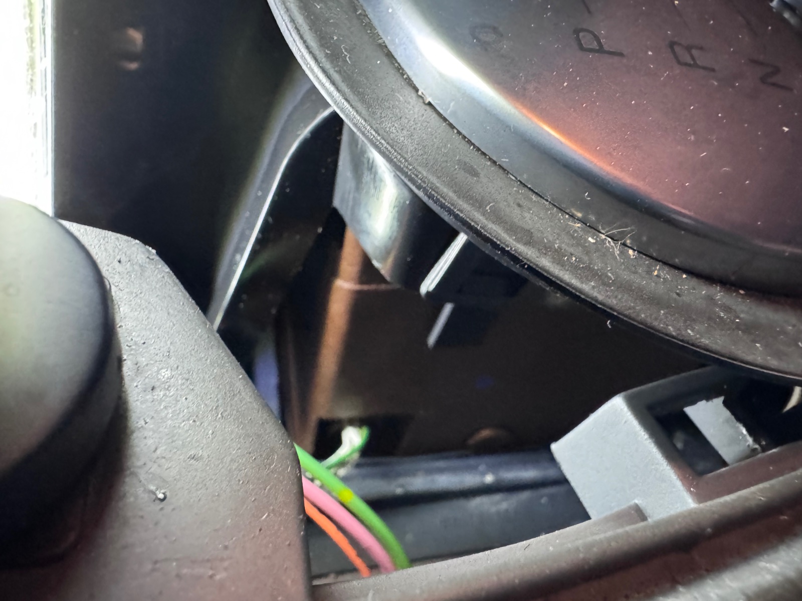

Pics below of how I currently have the gearshift uncovered (I had the centre console apart already).
Please can anyone point at anything that shows how to manually release the shift lock?

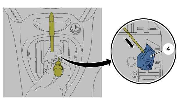

From Citroen documentation:
Check F18 in the BSI.
Release the "shift lock" ( 4) using a flat screwdriver.

Just looking back at my photos and comparing that info… I think the white piece you can see in the second pic, through the ‘window’ in the brown plastic… is the thing depicted in the service manual as item ‘4’ that you need to press down?
I saw that when I removed the trim and thought that might be it, but couldn’t move it with my fingers.
And the item below it looks like a classic old-skool solenoid.

I have never done this on a C5, but I think that you just need to pull the cover up a few cm, no need to remove the gear knob.

Just to update on this - you can't pull the gearshift cover up, there's only a couple of mm between the cover and the bottom of the gearshift knob.
However, it was indeed the white plastic item I mentioned, in the second pic.
You press that down (very little force required) and the gear lever releases. Thanks for the help pointing in the right direction from the service info!
