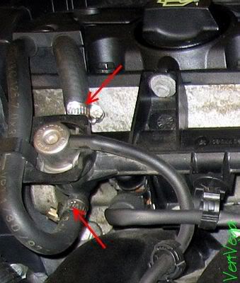

Usually cold autumn (or winter) mornings when you start the engine then you can get petrol smell into the cabin. Most probably it comes from the same location as in mine. Tighten hose clamps of the fuel pressure regulator (see picture). If they are still the original ones you can replace them with common hose clamps.
