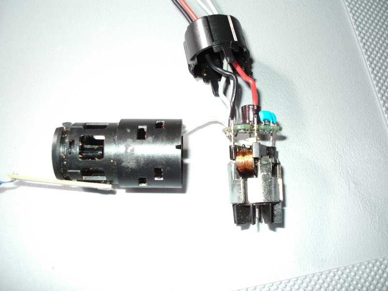

Sort of - should have made a better job of it at the time but perhaps this can help.VertVega wrote: Does anybody have a picture of this device, fan, propeller or whatever it is
Far left and just about in view, on the end of a thin strip of board, is the temp sensor that sits just inside the vent. The fan on the bottom right slots into the black plastic tube.

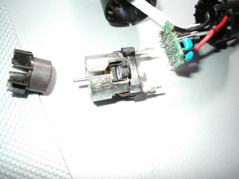

And this is the fan motor seperated from the controller (which is what had died on mine).
