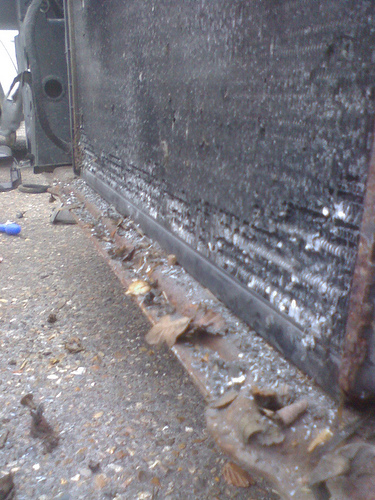

I have had a little bit of a fright after reading a recent post regarding the possibility of overheating problems if the water system is not bled properly after refilling.
Last week I finally got round to looking at the dead-end regions round the radiator where gunge could accumulate. I removed the radiator and found about a third of the region between the aircon radiator and the water radiator was full of leaves, dirt, etc etc. I could also clearly see that the fins on both rads were dirty.
So, hot detergent solution sprayed between fins then rinsed out with high pressure jetwasher.
Really pleased with the job; only bad bit was getting the radiator out. What a task, if only the designers had left another few mm clearance.
But when I consulted Haynes for replacing and refilling the fluid, I could see that there was some doubt as to just where the bleed nipples are for each model. I did fill using a high reservoir and this was successful, but I could only find ONE bleed nipple (on bulkhead, going into or coming out of heater). This bled ok.
I've done about 250km since then, radiator header tank still same level of fluid . But yesterday, after starting from cold I saw the gauge was slower than normal in rising up from the start point. Having had several cars overheat in my time I do keep a close eye on the temp gauge and this just didn't seem normal for the car. But the gauge still reads midway between 60 and 75 when up to temperature, except when idling for more than a couple of minutes.
Main thing I am asking is :::::::::::: how many bleed nipples should I have found? Sorry to be so long before getting to the point.
Cleaning radiator fins

You raise a good point about the radiator fins on Xantia's as the weather is now warming up for the summer. When I had my Activa (now Jim's), on hot summer days with the air conditioning running the temperature gauge would continue to rise until either I lost my bottle and turned the A/C off or the fans went onto high speed. Looking at the radiator/intercooler/A/C condenser from the front through the cooling fans they appeared to be clear of obstructions but when I unclipped the radiator and pulled it back I discovered all manner of debris had managed to get through the intercooler and condenser but collect on the radiator. I used a long thin nozzle on a vacuum cleaner to clear it all out which worked a treat and sorted the problem out.

You have found the leaf collector
I clean it once a year. It is very simple.
Just release 2 clips on top of the radiator and slightly bend it towards the engine. It doesn't have to be removed completely.
Air pressure or garden hose can be used for cleaning.
