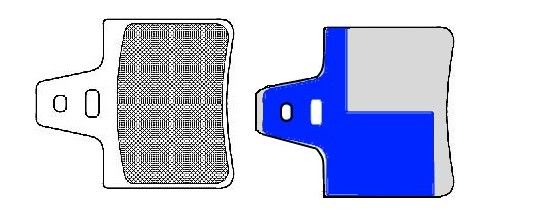

Just looked in the BOL and it shows a pic with the shim area nearest the ground and the small tang uppermost. So if you're happy to believe Haynes then that's the way it should be.

Rear brake pad shim fits as shown in the picture. At least they were like that in my Xantia.
I tried to edit this picture and the blue colored "thing" is supposed to be the shim
Last two sets I have bought didn't have any shims but instead they were replaced by some kind of a surface material added on the back side. They work fine.

A bias shim like that does matter which way up it is - I've seen one Xantia where the bias shim on ONE rear brake pad was upside down and the other three were the right way around and the pads whose shims were correct looked normal, but the one whose shim was upside down had a HUGE angle on the surface of the pad, there was about a 2mm thickness difference between the two sides of the padAndersDK wrote:doesnt matter really as all the shims do is to take the pads a bit out of true preventing them from hi-frequent vibrations.
The idea of a bias shim is to apply more pressure on the trailing side of the pad in the direction of normal rotation, and putting it on backwards will apply more pressure on the leading side and cause it to dig in, resulting in very uneven wear...
So yes, it does matter
