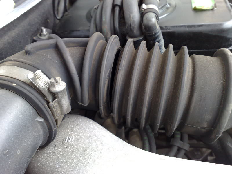

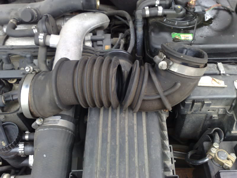

Do you think this may be the cause :?:
I was about to remove the spark plugs when I noticed the split hose.....

Not unless the power loss is when the engine is very hot as then it will be sucking in hot air (underbonnet) rather than cool outside air, other than that the issue is sucking in unfiltered air.

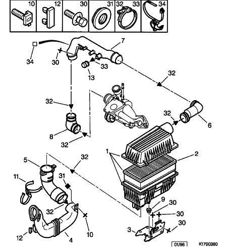

Hi Spud
item number 10 in this i think is what you want
0290 02 170076 AIR FILTER AIR HOSE AIR RESONATOR TURBO DIESEL XUD9TE SINCE RPO NO. 06885 OR DIESEL TURBO XUD9SD SINCE RPO NO. 06885
Part Number Description Quantity Price excl. VAT Price incl. VAT Total incl. VAT Selection
000014247C AIR HOSE 14.38 GBP 16.54 GBP 16.54 GBP
Hope this helps
Colin

Unread post by admiral51 »
:oops: :oops: :oops: :oops: Thats the part for a TD :oops: :oops: :oops: :oops:
Will check again for the correct car and repost :oops: :oops:

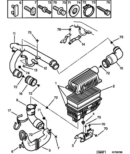

Right lets try again :lol: :lol:
Part number 6 in this photo :)
000014245C AIR HOSE 26.73 GBP 30.74 GBP 30.74 GBP
Hope thats better.....but not the price increase :roll: :roll:
Colin

DickieG wrote:Not unless the power loss is when the engine is very hot as then it will be sucking in hot air (underbonnet) rather than cool outside air, other than that the issue is sucking in unfiltered air.
It's a CT turbo isn't it ?? That would make a tremendous difference to performance as all the boost pressure will be blowing out the split :)
seeya,
Shane L.
Not at that point Shane, that section of pipe is prior to the turbo.
