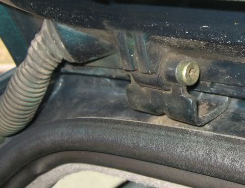

While checking the rear window wiper I also gave a quick look at the tailgate hinges.
The shaft is same as in the doors (Torx 40) and the U-shaped hinge is fixed to the body.
I have also noticed rectangular plastic covers in the ceiling trim, right under the hinges. I have not opened it but there might be some "adjustment" screws there.

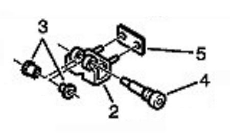

Here is a detail from the Xantia service pages, tailgate glass and moulding.
Number 5 is called Centering Shim. So could it be adjustable :?:

Thanks, another job to add to the list.
