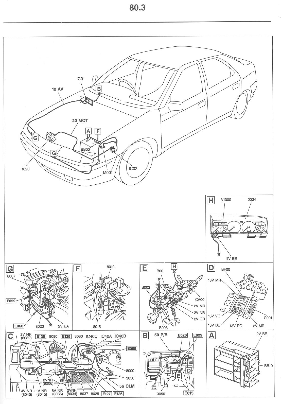

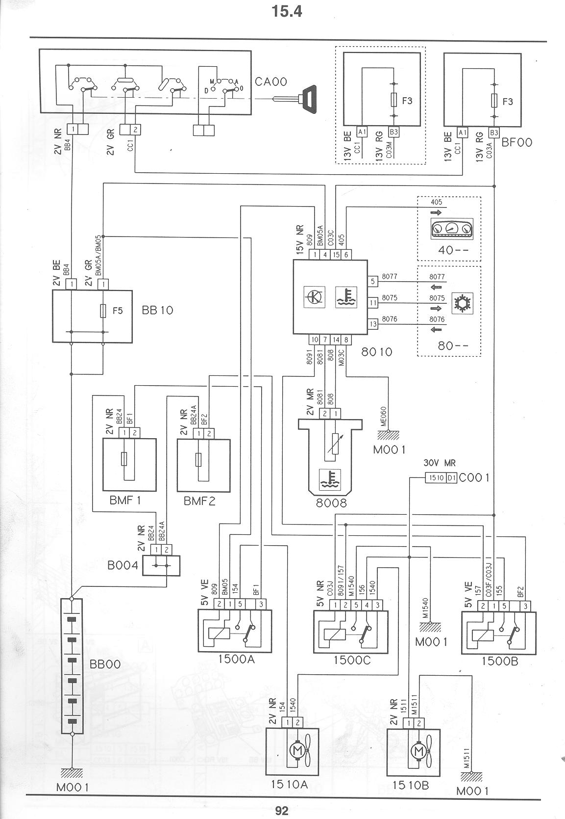

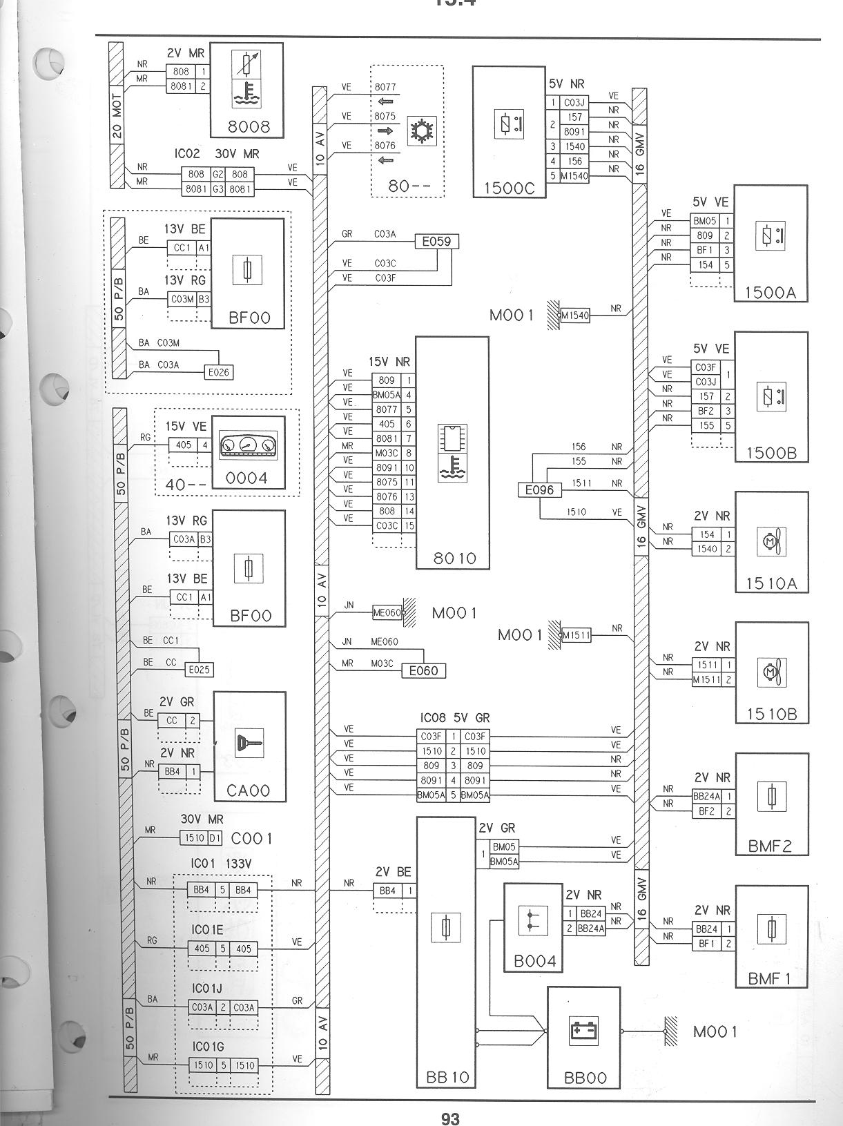

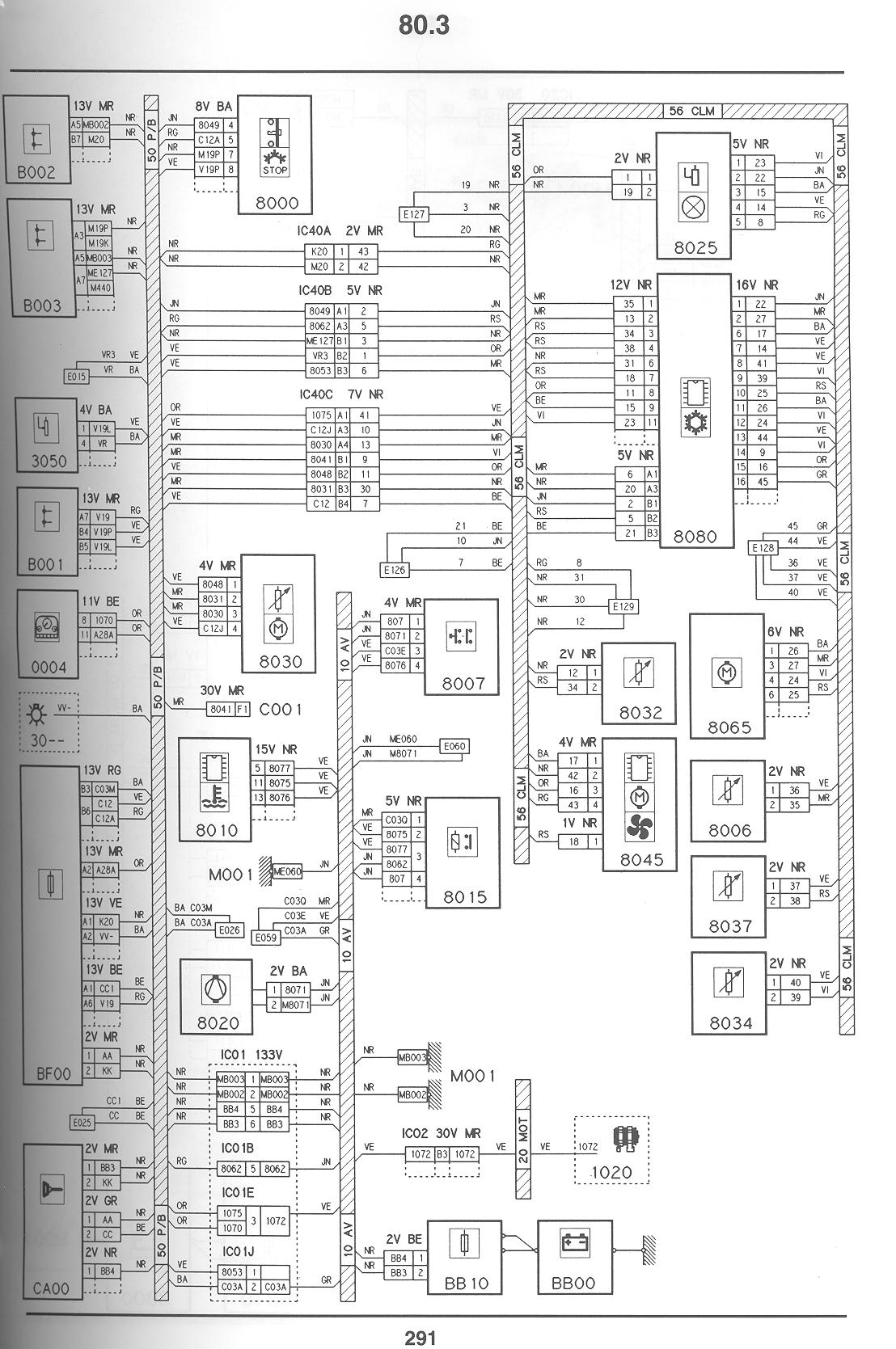

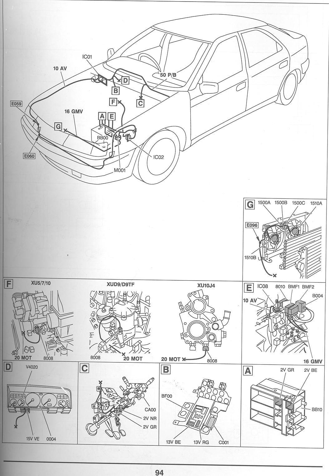

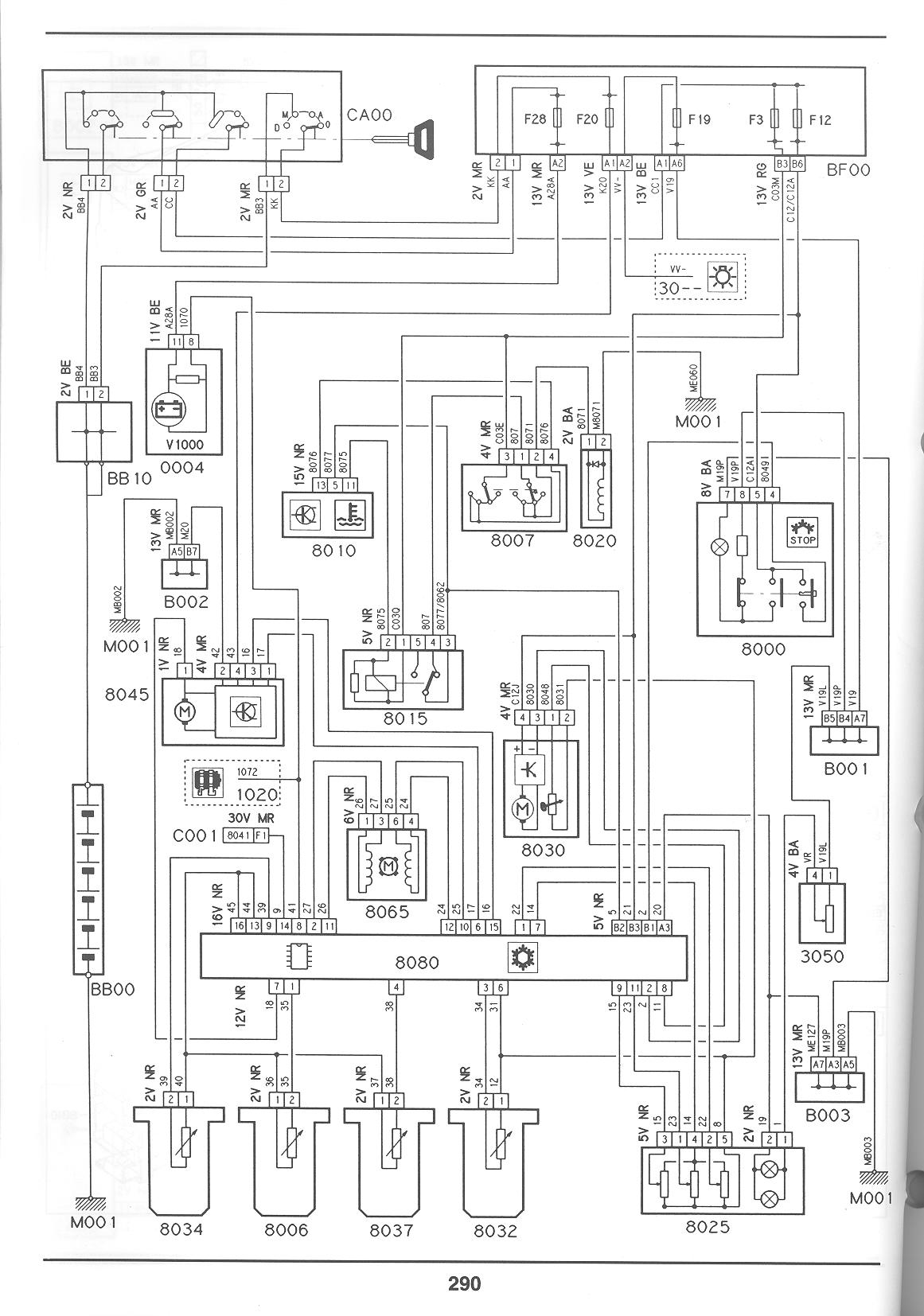

Here are the diagrams applicable to the early MK1 with A/C:
These first three are the A/C proper..
A/C Circuit
A/C harnesses
A/C Component Locations
These next three are for the engine cooling fans...
Cooling Fans Circuit
Cooling Fan Harnesses
Cooling fan Locations
Note how pivotal harness 10AV is
Hope they help nail the problem. My book has now completely fallen apart scanning those
