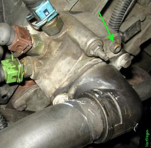

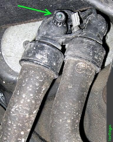

These pictures are from my Xantia and I have added red arrows showing bleed valves.
The top one is on the heater matrix hose (Engine room).
I can see from Cloggz's picture that in 8V the thermostat housing is a little bit different than in 16V.
I hope this helps.

Thanks for the replies job is now done :D :D
I could only find the 2 bleed valves as in the pictures :) :)
