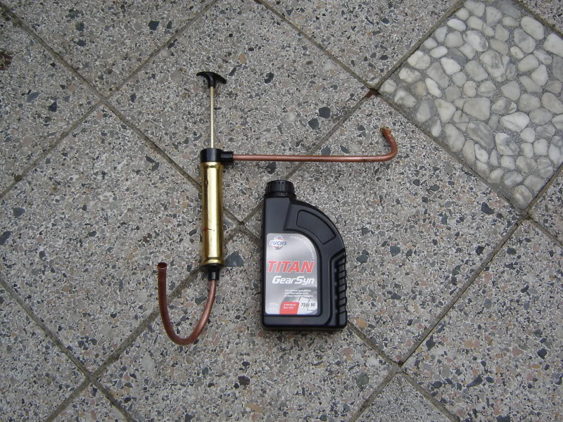

Ok Guys.......another "must do" job done . 2 litres of dirty oil out. Looked like it had been in there since new.
This was my contraption for filling from underneath on ramps.
It can also be used for Colonic Irrigation

Is that the pump or the gear oilt can also be used for Colonic Irrigation Shocked
