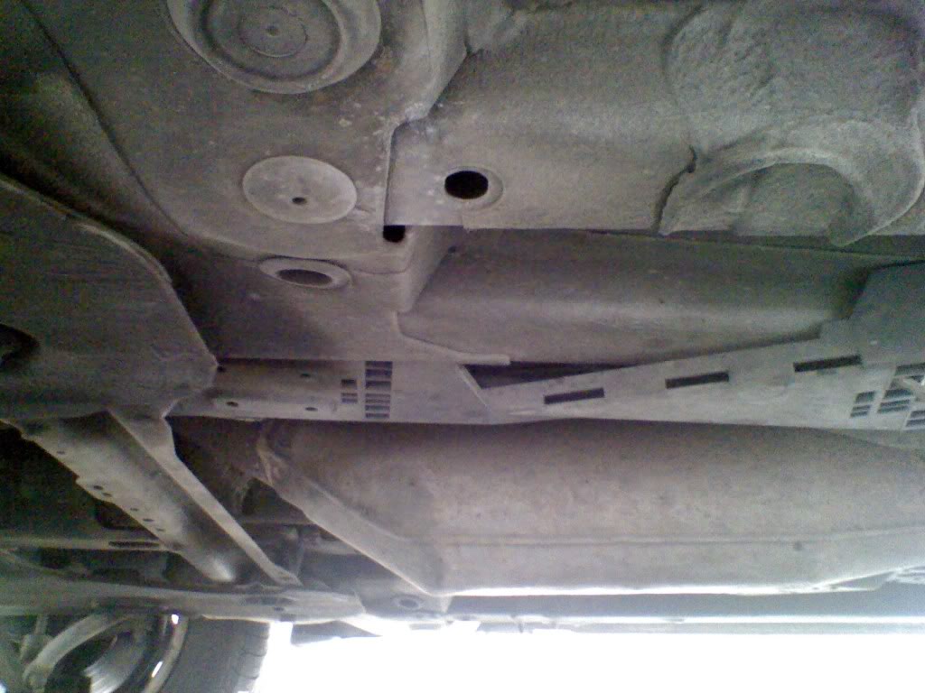

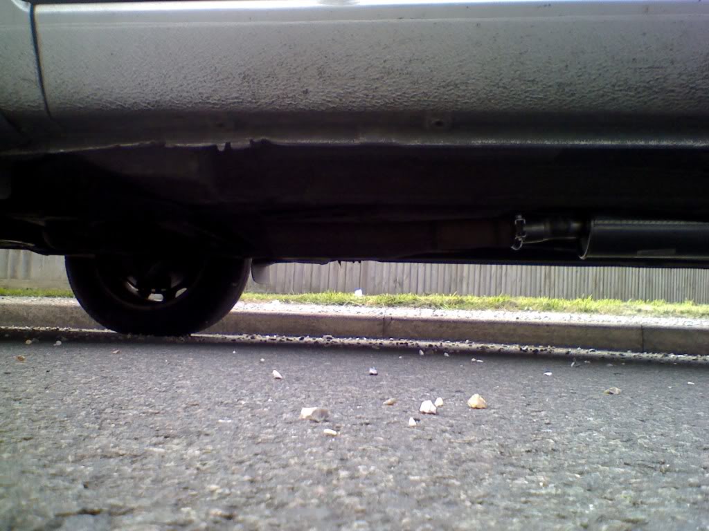

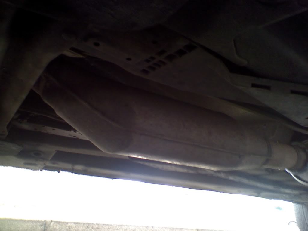

Here are some pics of the cat and mid box.
I set the car on service high to take the shots- I don't usually drive around at this height. Even on drive high setting the suspension is very hard. Is this indicative of a sphere change due?
Anyway, here are some pics of the cat and box.
I get the idea that they might be hanging low, but would really appreciate other opinions.
Thanks!
Dave (V6)

To me it looks as if your cat needs turning before its clamped into place by the middle section, from where it is now release the clamp twist the cat re-tighten, job done.

I think yours looks OK
