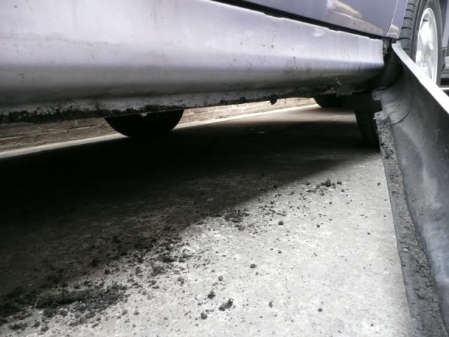

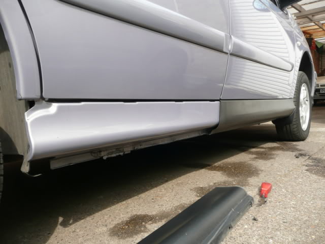

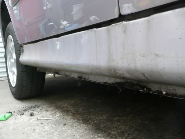

Yes those are the ones come of in two parts each side, held on with a series of re-usable (with care) plastic fasteners underneath.
Mine? well mines a 2001, in some places there is a considerable space between the plastic trim for that is what it is and the real metal cills underneath, this was absolutely packed with years of mud bits of grass you name it all slightly damp of course.
The paint on the cills was blistering in many areas, although underneath the galvanising was holding up (just). The blisters appeared to be caused by osmosis rather than puncturing of the pain film. I.E water had penetrated the paint film by osmosis and then started a reaction with the metal underneath the resulting pressure causing the paint to blister.
There is not an adequate seal between the inner wheel lining and the plastic trim which means that water and mud will get forced in at quite high pressure and work its way down under the plastic.
Yes I do have some photo's however as I can't directly attach them without jumping through hoops and this web site doesn't have a files section they won't get published here. However there is something else which requires publishing of photo's so when I get them of the camera I will try and find somewhere convenient to put them.

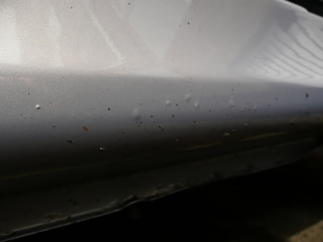

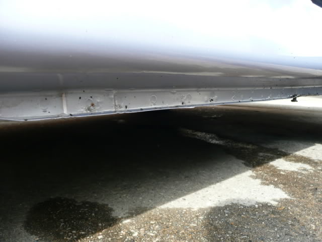

I had a look at my offside sill, its not as bad as i had thought it might be, this is what it looked like as i took the trims off:
There was a bit of a build up of stones and mud, but nothing to worry about.
However, i think this might be what you mean about 'blistering', although mine only had a very small patch of that. There is slight rusting along the very edge of the sill, but that happens on all cars.
After i had cleaned it up:
I need to waxoil under there, but didnt have any handy at the time. Although its an easy job to remove them, if anyone else does remove them, you might need a few spare fixings, as some had gone soft and were not doing their job on my car.
Chris.
Chris.

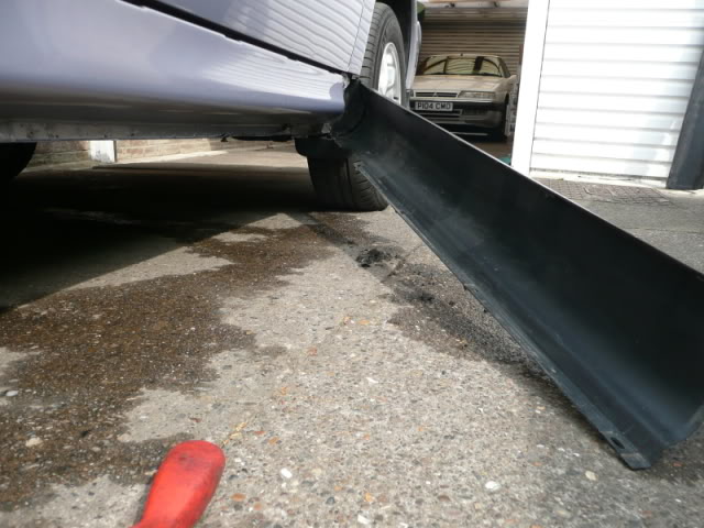

I took off the sill covers the other week - kind of dreading what might be lurking behind the cover, given the previous owner lived in the country side.
There were a LOT of little stones (probably from the loose metal of the unsealed roads) and quite a bit of mud (mostly dry though) stuck on there.
Once I scraped it all off with a plastic scraper though, the sills themselves look like brand new! No signs of corrosion or bubbling at all - I was pleasantly surprised by that, to be honest.
