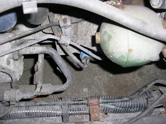

This is probably going to make a few people chuckle but can anyone please tell me if the blue plug in the following pic is the location of the oil temp sensor as my gauge is not working
Any hints/fixes/checks before i spend some hard earned stuff at the stealers most appreciated :)

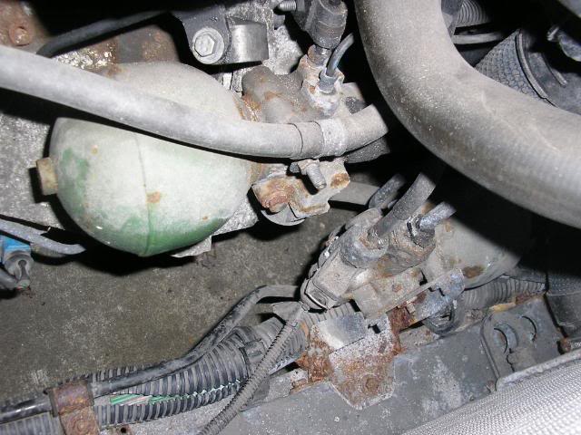

Which of the spheres in this pic is the acc sphere never had anything other than one in this region before :lol: :lol:
Thanks in advance

The accumulator is the sphere on the left/attached to the engine, the one just behind the radiator is the front Hydractive sphere.
I think you're right about the temperature sensor wire but I don't have my TD to hand to confirm it 100%, what I will mention is that on non turbo Xantia's the oil temperature gauge rarely seems to move from my personal experience.

I'd say the blue plug is the oil temperature sensor and I'll agree with Richard on them reading not a lot on a MK1.
My Activa oil rarely crawls much off the end-stop but yesterday it actually struggled all the way to 50 degrees :lol: :lol: And that is hot for me! Maybe I do't drive it very hard :oops:
Remember an alloy sump in the breeze and given the position of the sensor, the oil is going to be nice and cool there.
On a MK2, they seem to read better. My old MK2 Activa used to run at 80 degrees :?

Glad the acc sphere is a bit more accessable as that needs doing first not looking forward to doing the Hydractive centre sphere :lol: :lol:

Colin, quick wander off topic: the pictures show that the slit in the shroud holding the wires along the bottom of the radiator is facing forwards.
Water can get in, and rot the wires.
The opening should be at the bottom, to let the water out.
Rotten wires in there cause strange, unrelated electrical faults.

Clogzz wrote:Colin, quick wander off topic: the pictures show that the slit in the shroud holding the wires along the bottom of the radiator is facing forwards.
Hi Clogzz
the pictures were taken shortly after i aquired the car and after some electrical fault tracing in that particular loom the slit in the shroud is indead now facing down :) :)
But a ruddy good spot 8) 8)
Colin

Have now done the service and with an oil change the oil temp gauge is now working and not sat on the bump stop :D :D
