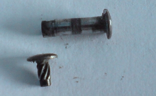

I find that if you try to drill the pin out sometimes it works and sometimes it spins and melts the plastic case. These days I carefully work the tip of a very small thin bladed electrical screw driver under the rivit or pin head. You cannot tell which it is until you get it released but either will do. A bit of levering and moving position with the screwdriver blade and the key blade is released. The bonus is that 90% of the time you can reuse the pin and key spring. Still the pin kit comes as a pair in a packet for less than £5 if you need one.

In this case, there is no coding of the blade, and the rivet can be removed non-destructively to allow the blade to be moved to a new case (I have done it a couple of times).
The rivet is splt in the middle, and if you put a suitable blade (maybe a wide screwdriver with a thin edge) between the blade and the case, and bend the case a couple of mm, the rivet should just pop apart, or at least enough that you can get a tool directly behind one of the rivet heads to persuade it that last mm.

Plip Rivet
Unread post by SLYTZD »
Simon
