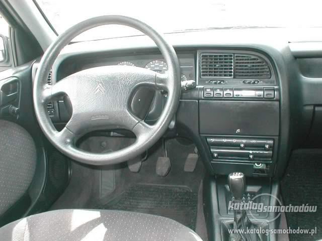

Also, does anyone know if the below radio cover still fits if you have an aftermarket stereo unit fitted or is it only for OE stereos? If it does fit, does anyone have one?

Yeah the cover fits if you have an aftermarket stereo. Citroen part number is 96118897ZL. Best of luck finding one... :lol: :lol: There was a thread about them not so long ago.
edit... Just noticed the steering wheel in the pic you posted has no radio controls. What's that all about?

Vince.
Have you noticed that your steering wheel is on the wrong side of your car Image
