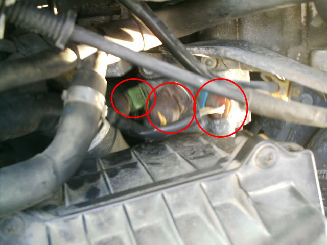

Right, my brother can't tell which sensor is which under the bonnet and has supplied a pic showing the thermostat area where 3 sensors are located in close proximity. Can anyone tell me which one is the coolant temperature sensor, the one that may be the cause of cut-outs and need bridging as a temporary check?
Thanks
Thanks
