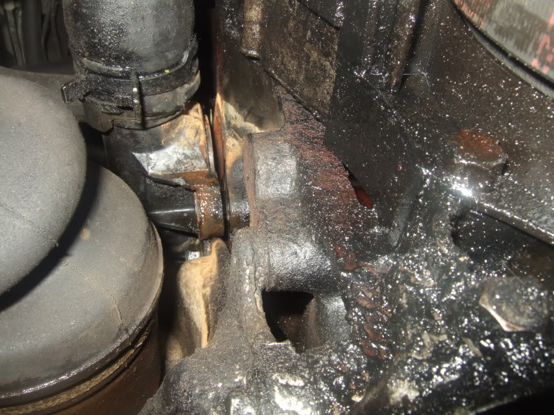

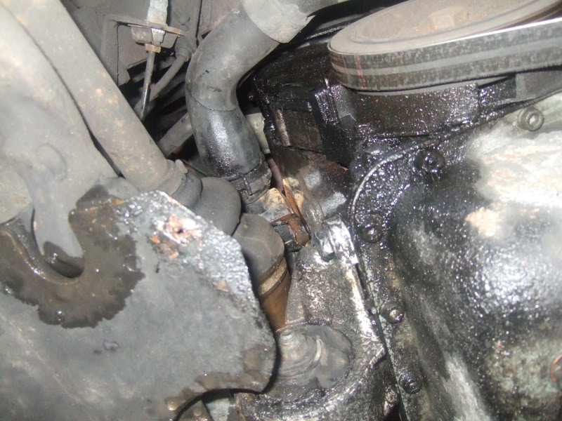

Water leak
It came with a water leak on the drivers side of the engine, I think it might be the thermostat area. (?) a fat pipe bolts to the side of the block, its rubber grommet/gasket had split, bad aftermarket fitment I think.

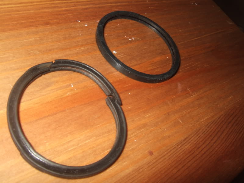

I got a new one off GSF, I awkwardly tried to fix it in the car park on my bill but no joy, got it in but with only right hand able to reach up and no torch holder, i don't think i got it sealed/seated up correctly! Difficult with only one side visible. So one to re try this week.

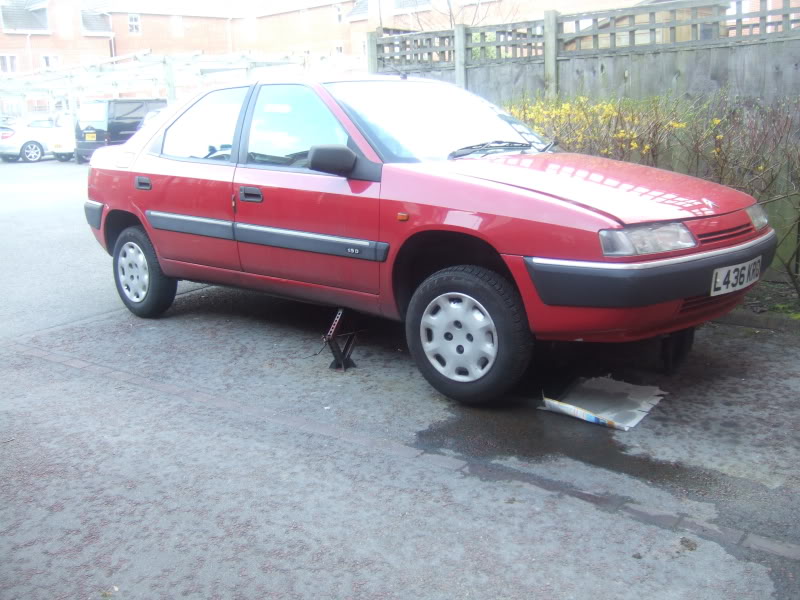

Pics for your (dis)pleasure
Citroenmad
Posts: 8125
Joined: 04 Dec 2008, 22:08
x 110
Unread post by Citroenmad »
Looks very tidy 8)
Its likely the spheres will be in need of replacemtn after 7 years. They should be regassed every 3 years or 30K miles, so its well overdue replacements i would think.
An LHM flush and change would probably be a good idea too, you might also want to get the front spheres checked for pressure, as they might be getting low now too.
Looks like a nice example, not many early Xantias about now.

Unread post by lexi »
It`s quite a quaint example. I had the non turbo on a ZX. Slow but gets you there and doesn`t put much pressure on head gasket.
Excuse if I`m sucking eggs but I take it you have axle stand under subframe to back up the jack?
If you are new to these cars read up on all the precautions RE supporting the blighters.

lexi wrote: If you are new to these cars read up on all the precautions RE supporting the blighters.
Yes, Axle Stands are essential and NEVER rely on a jack. These cars can KILL.
Lecture over. Good to see an early "sinker" in tidy condition :D
The new ring should sort out the leak on the water distribution block. The coolant in there looks a bit rusty suggesting it's been running a bit short of anti-freeze recently. That's not good in these engines and they do like a good diet of 50/50 water/antifreeze to ensure a long life. As well as shorteningt he head gasket and heater matrix life, running on low anti-freeze can runst out coreplugs and the favourite one to go is the one behind the diesel injection pump and it's naturally the least accessible :twisted:

Firstly the safety thing, does look dodgy doesn't it! :?
We picked the car up on the 31st, drove it home and went for a quick test, and the water was leaking more than I expected. My GF was keen to get it done and sorted taxed and fixed as we were due at a wedding on the 2nd, ended up with only one morning to get to Gsf and have a crack at fixing and all my good tools are kept 35 mile away. yeah not ideal really. there was a big fat wheel and tyre safety netting the front end out of sight so not too dodgy. I've heard about these dropping on people so I wouldn't be quite that daft :shock: thanks for your concern, will have more holding up next time.
Armed now with a bigger set of pliers etc, an hydro jack, an axle stand and the other stuff now. So need another crack at it with less time stress. looking at the old rubber i thing that was snagging at a strange angle. I've got long arms and fingers and don't give up too easily...
Thanks for the info on the water/coolant, I picked up a litre of proper Citroen coolant at GSF while I was there, no idea if thats enough, possibly not if we're talking 50/50.
