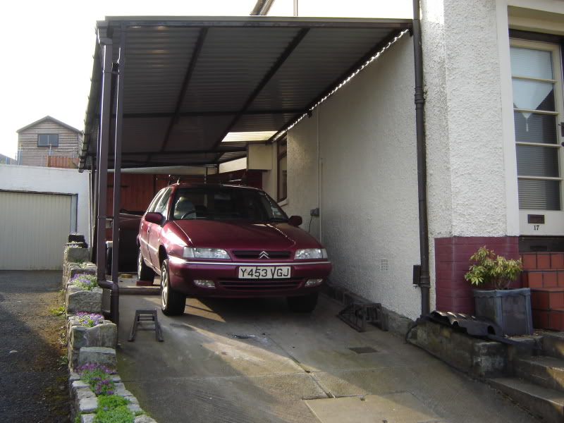

I posted earlier that I had the chance of this model.
[/img]Image
It`s had an owner for whom Citroen suspension has proved one of the mysteries of the universe. Also a garage that did the servicing who constantly shook their heads every time he took it in.
Anyway. It doesn`t seem to need much for Mot. First off are front discs and pads. It is 110bhp model. Are the front brakes the same as my 1.9td? Maybe bigger discs and more expensive?.
I will get the stuff this week. Question: Is it better to Hydraflush and change fluid before I do the discs and change any spheres ........or after.
There is one more issue for Mot. which I will bring up after I do the above work. Hey guys! What a nice quiet engine and got a bit of poke.
I still like my old "tractor " 1.9td though. :lol:

Has that car been run an flat spheres??
Looks nice however, in the first pic, it looks like the rear arm is leaning in a bit, the wheel doesn't look straight. or is that just the picture??
Ditto then brakes, the 110bhp uses V6 / XM Brake pads... estates always have, I had a 19.td estate on a P, 1996 in, and it had the bigger pads and disks...

Paul: I don`t know about rear arm...it was ok on Mot.
The suspension is on hgh in pics.
Got the Discs and Pads at GSF....£107. Ialso got the Hydrocourcinage and a front accumulator sphere. I will do the fluid change first.
On the ramp at MOT the rear suspension took forever to come up.......so not quite right there. Guy I bought it from constantly rabbited about how complicated the suspension was. Kept going on about how it had new front spheres a year ago..oh yeah! what about the centre one? did ya fall out with that? It looks like it`s been there a long while . It`s ticking and has a leak. Hope it aint damaged the HP.
