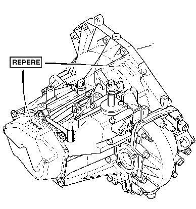

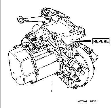

Alan,
The 1.9TD Synergy it seems could be fitted with two different gearboxes: The ME up until RP7111 and the ML5T from then on, both with cable clutch.
This is the ME
And this is the ML5
The ME appears to have one gearchange cable and the ML5, two.
Both 'boxes appear similar inside.
As soon as you have a positive ID, I'll dig out some exploded diagrams...
