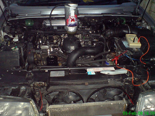

Well you have to consider that I'm used to working on a XM 2.5. To remove just the plenum chamber on these you have to work under the car as well as above it. After one of those the engine bay on my HDi seems empty.
Here's one I made earlier-
Everythings relative I suppose.
Are the solenoids are not fastened to the bulkhead under the plastic tray?
Steve.
