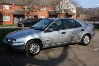

Hi Everyone
Just bought an Xantia Exclusive with the 2.0 HDI engine. Very pleased with it so far although i have only owned it for a week.
Just wondering if theres any special or imprtant things i should look for or know..There does not seem to be any problems with it but i do like to be prepared..I did own a V6 Omega before buying the Xantia but economy was the main reason but i did want a comfortable car with a nice ride and i went for the Xantia for that reason..It also has all the toys with leather so i am well pleased..
Any info would be appreciated. Hope i have not stepped out of line by adding a photo in this post.
TIA
Russ..

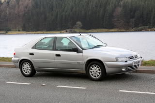

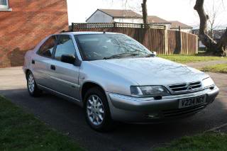

I have plenty of photos....
Unread post by Xantic »
Ross_K wrote:Welcome Russ
The more photos the merrier. 8)
Just a couple more for you.
