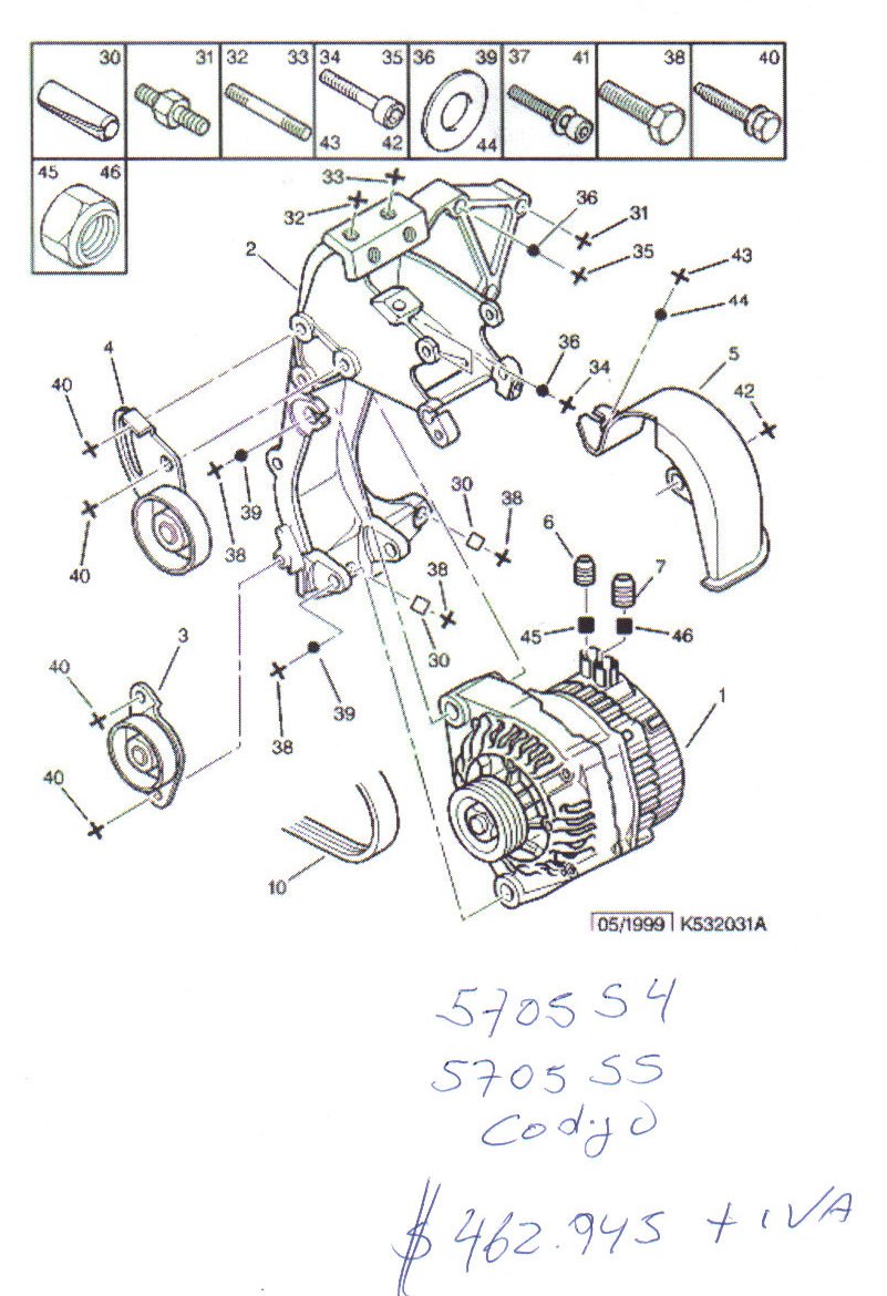

This is my alternator. Image
The price is $462.945 chilean pesos plus tax. Thats almost exatctly US$800 plus 19% VAT.

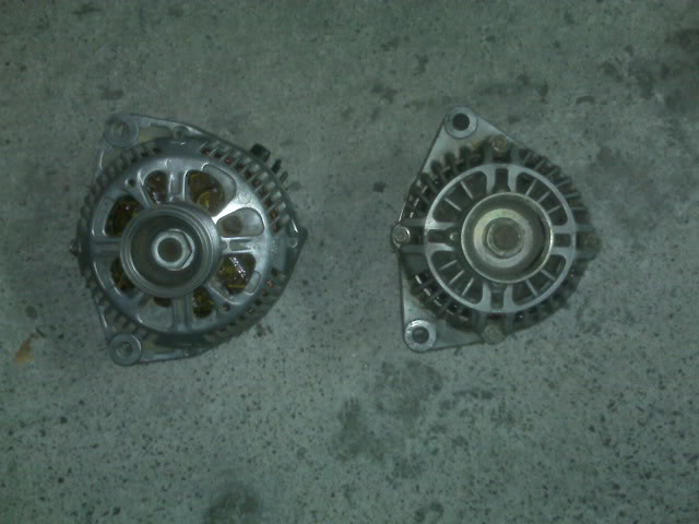

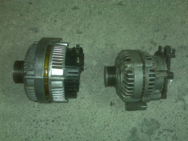

Update... alternator is in place. It was MUCH larger and MUCH heavier than the Mistu unit. I had to remove the right headlight to be able to move the air hose from the intercooler to the throttle just to shoehorn it in place. Once in place though, it fits perfectly and looks a lot like the one in the parts catalog image.
Pictures of old and new. Valeo is the new one and on the left:
