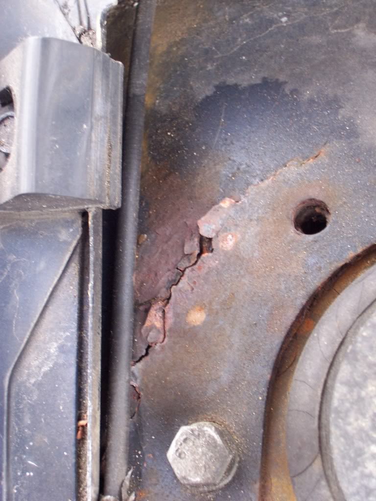

Does this look like an MOT fail?
Village
Posts: 151
Joined: 21 Sep 2005, 19:21
x 2
Unread post by Village »
This is the top of the o/s front suspension turret on my ZX:
I reckon it's a fail, to the extent that I'm weighing it in tomorrow! There are a load of other things wrong with it, but this looks like a biggie.
French car free zone....
Forum Treasurer
Posts: 12596
Joined: 07 Aug 2002, 17:12
x 1489
Unread post by RichardW »
I reckon that's a fail, and several hours or welding / fab to put right.
Posts: 55097
x 8397
No doubt about it I'm afraid :( A fail.
Reminds me of the old Fix Or Repair Dailys back in the 70s. They used to make special repair plates for their strut tops. Were they called something like "Flitch Plates"?
citronut
Posts: 10937
Joined: 29 Apr 2005, 00:46
x 94
Unread post by citronut »
frayed (round the edges) so failed, in fact it looks like the strut is on its way through the inner wing, ZX's seem to suffer with tin worm quite a lot, especialy around the front inner wing area, i dont know if you can buy a repair panle like those sold in the day off the "fixit or rust daily's" as Jim said
regards malcolm
ACTIVE8
Posts: 2317
Joined: 16 Nov 2004, 16:49
x 6
Unread post by ACTIVE8 »
Yes that certainly is a failure on a ZX with that amount of corrosion, and lack of strength!
So, although the Xantia also has a problem in this area at least it does not affect the body shell unlike the ZX, and the strut tops are replaceable I.E. akin to a flitch plate.
This amount of corrosion on a strut top is the sort of thing that most people would have thought that we left behind in the past, when this was a common problem from the "Life On Mars" days!
