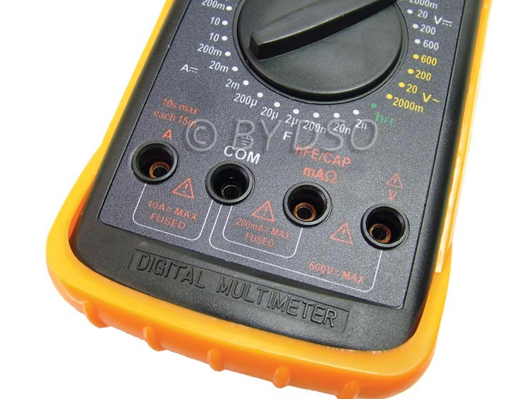

You can buy a voltage tester for a couple of quid from DIY electrical shops but one of these wouln't go amiss.
£10+postage! (Click the link)

myglaren wrote:You can buy a voltage tester for a couple of quid from DIY electrical shops but one of these wouln't go amiss.
Why send me a link like that?
Posts: 28604
x 5631
Because it is a cheap and rugged avometer. Why else?
