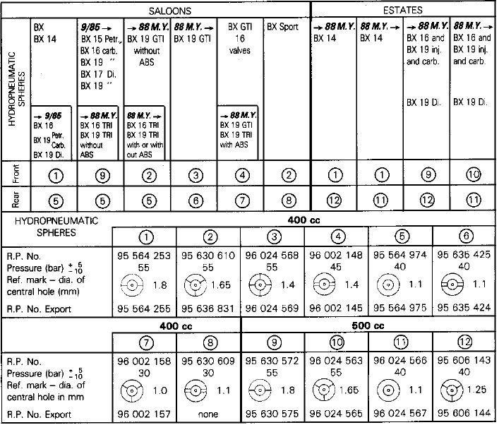

Does anyone here know which spheres the TXD uses and where I can find them. There are mixed views as to whether the TXD model should have soft or firm suspension, at the moment it's firm, so I'm going to try and change them to see if it makes a difference. The general opinion is that it needs the soft ones and mine need replacing.

According to this chart it should be 9 on the front and 5 on the rear.
I perused this chart to find the softest possible combination.
It certainly "floats" but it didn't smooth out those small high frequency perturbations as I had hoped.

These are the original TXD spheres fitted at front :
95.630.610 400CM3 55BARS
- 1,905L & INJECTION OG 4X4
- SEDAN & DIESEL & TURBO
- 4X4
- 19 GTI UNTIL OPR 03877 (not 16V)
96.024.568 400CM3 55BARS
- STATIONCAR & DIESEL & TURBO
- 19 GTI SINCE OPR 03878 (not 16V)
If you want better drive comfort, you should defo try the Stationcar (TRS/TRI) spheres, which is my preferred sphere type :
95.630.572 500CM3 55BARS
- SEDAN EXCEPT 1,360L
- STATIONCAR UNTIL OPR 03877 EXCEPT 1,360L
- STATIONCAR & 1,580L SINCE OPR 03878
- STATIONCAR & 1,905L SINCE OPR 03878
OPR 03878 = 22june1987
- 4X4
