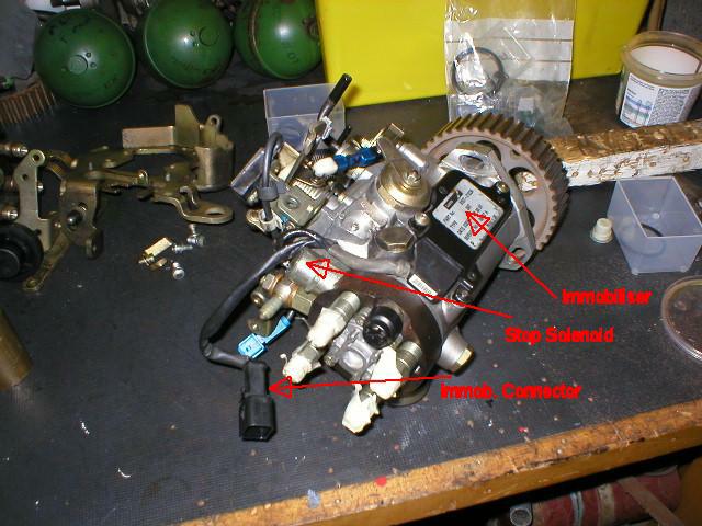

Ahh, you may have the Lucas pump then. It should still have two connectors on it, a blue one and a black one.
The immobiliser module hides at the back of the pump behind armour but the stop solenoid is hard-wired to the immobiliser module.
See if this photo looks like yours:
It shows (with the armour fully removed) the immobiliser module, the stop solenoid and the connector for the immobiliser.
That's the cold injection advance solenoid connector anot not connected with the immobiliser or stop solenoid at all.
De-armouring a Lucas is a lot easier than a Bosch but it still has to come off the car to do it. Also, if you do away with the immobiliser, you need to replace the complete stop solenoid with an earlier non-immobilised version, one with a terminal on the top.

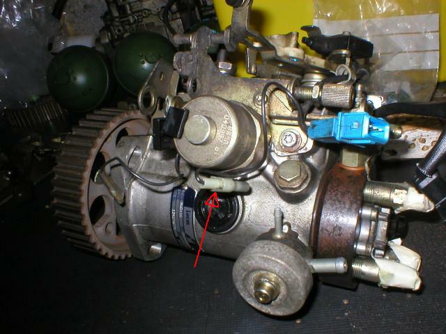

You mean this one:simbabull wrote: there is a wire at the front of the pump which unclips and pulls apart,is this the plug i need to check the connectors on?? i cant see any other black plugs or any plugs other than that one.
thanks again
