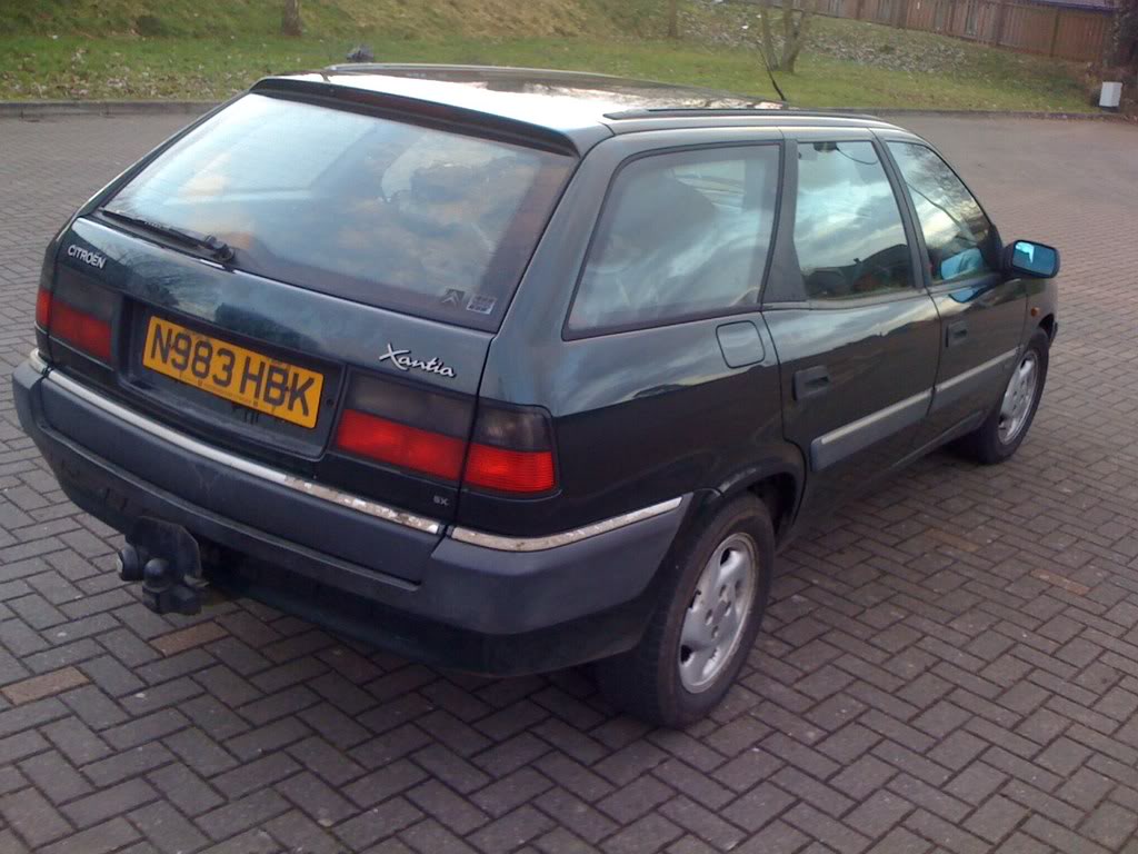

After very favourable findings using Shell V-max diesel my father used,
I decided it was worth treating my 1996 TD Xantia SX estate to some on
the way to it's new MOT. That's all fine and dandy but I didn't realise the
v-max is unleaded as well as diesel and spread randomly on different
pumps around the local Shell garage.
So, after 10 litres of unleaded I finally twigged there may be something
awry with the smell of the fuel I'm filling into the tank! OK, been here
before with smaller volumes mind on a CX and at the time sought technical
advice ringing up the AA people who said so long as the ratio of diesel/
unleaded was below a certain %age no harm will come to the car and it
will actually go a bit better and this is used by Scandinavian DERV users
to stop waxing/freezing of fuel tanks.
All great stuff but I couldn't recall the %age although I know it is a whole
lot worse having the wrong %age of diesel in a petrol car than unleaded in
a DERV car.
Time pressing, I decided to drown the unleaded and brimmed the tank with
45 litres of diesel. Not sure that ratio worked but the tank wouldn't hold
any more and I didn't think the old Bosch pump was too fussy seeing all
the other stuff that get's pumped through them. Problem is, the car runs
but doesn't like idling and smokes really badly. Is this RIP for the engine
or the pump or both?
The car's MOT was aborted due to the smoke too after I'd rebuilt the front
suspension and treated the car to spare Activa rims.
Andrew

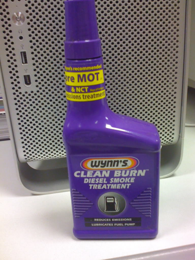

It seems suggestions made earlier of my Td's demise were premature!
I must say it looked and sounded bloody awful on Saturday after I'd
emptied the tank and put some of the 'ard stuff in. Happily there seems
to be life in the old dog yet! I filled it with DERV with a pop of some
optimistically titled Stop Smoke from Wynn's costing a fiver that promises
to help fix everything from World Dept and World Peace as well as lubricate
the pump innards or somesuch - the long list of benefits sounds wonderful!

The long hard run on Sunday with an engine in the boot and the Wynn's
has helped (as well as the removal of the unleaded I guess!!! ).
Xantia with TWO engines:
The stuff wot I used:|:D
Right, now to sort that damned "STOP" lamp on the other estate!
Andrew
I must admit I didn't see that one happening after the chugging fallout from
the engine on the weekend. The bad news is the damned car failed to get a
pass as the nearside headlight aim was too low and the OSR numberplate
light had a dodgy connection!
I cannot understand the headlight aim bit (one side only) as the car has
always been tested by the same place and I haven't touched it, EVER! He's
advised or initially failed every car I've taken there on headlight aim in the
past two or so years and I reckon it's because the test equipment has been
recalibrated as I don't tinker with my headlight aim or have height corrector
issues! If anything I'd rather have it aimed slightly lower than many
seem to like on their blinding lights!
Andrew
