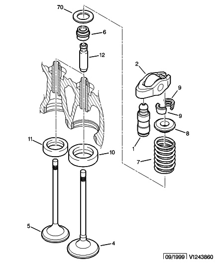

I can confirm this, my timing belt slipped a month or two ago.
The engine, as said, is interference. However, the valves are perpendicular to the pistons, that is to say they are fitted in the head straight, rather than at an angle.
This usually means that any contact will make the valve shoot straight back up the guide and will break the rocker which takes the force. I was lucky and got away with just the 1 broken rocker, it is more usual - I'm told - for more to be broken. You would have to be very unlucky to get a bent valve but it is not unheard of.
The rockers are around £16 all in from Citroen dealer. Item 2 in the below diagram (you can see how the rocker transmits the movement of the cam to the valve, Item 1 being the tappet that automatically adjusts the valve clearance using oil pressure)
