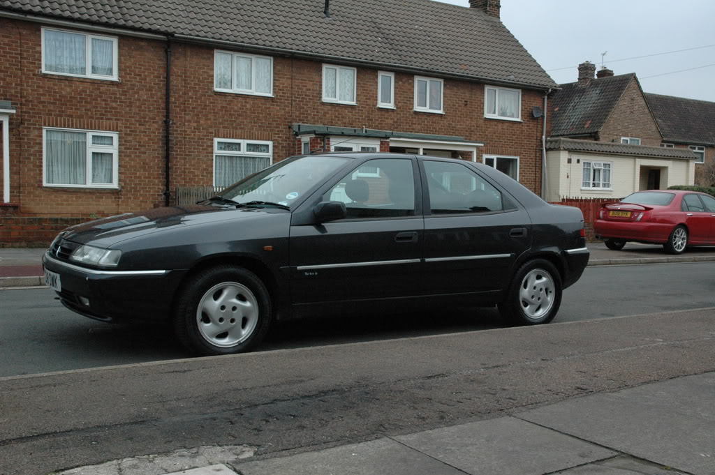

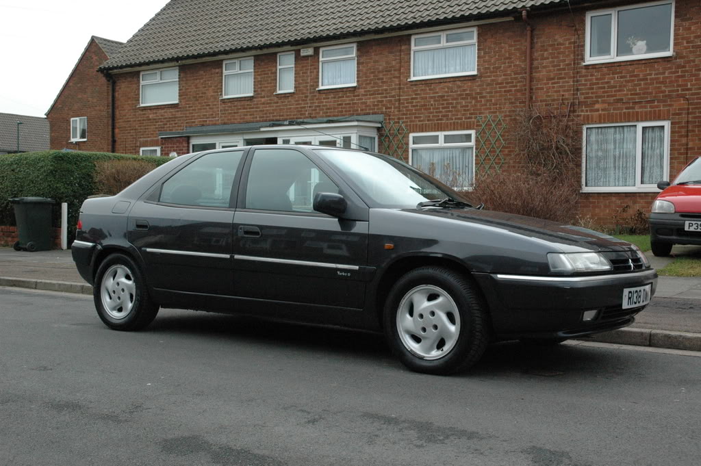

Got my activa alloys on so its time for an update. A mate of mine needed to collect some parts from london at the same time, 620 miles in total last weekend! Had no problems luckily as i forgot to take any tools :lol:
Before i went i fixed the dodgy aerial with a freebie from the scrappy, renault scenic base & super long mast, seems to have sorted it out. Had a carry on fitting it as i dropped the metal disc in the box section, fished it out with a magnet luckily as i could imagine it rattling all the time.
Also have fixed the rattly bootlid. On the journey back i started getting a bit of a wobble on full throttle. Im reckoning the inner cv joints are worn on the shafts, every french car i have owned has done this so another job to add to the list.
A couple of pics, have given it a wash now the snow has gone. Still need to touch up a few bits bit it looks a lot better with the wheels on.
