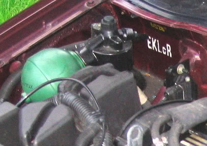

I seem to spend my life explaining to ebay sellers where it is so I do know
this one off by heart.
Engine bay bulkhead on driver's side near offside strut top/sphere in white
stencilled digits 1.5" high lettering (usually white or black dependent on car
colour) then ending in CR for saloon or MR estate like so:
I've found an identical colourmatch between the two if the first part of the
code matches. S2's sometimes have an additional letter in the paint code too.
I could probably even guess what code yours is if you say it's a dark green s1!!
The RP Replacement Parts number unique to the car is above in 4 yellow
numbers!!

As above.
My MkII doesn't have it there though, so if you can't find it there - look on the drivers A pillar for a sticker. It's on there.

If you have a 2000 MY Xantia the paint code may well be on the drivers side A pillar just below the check strap.
